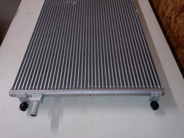

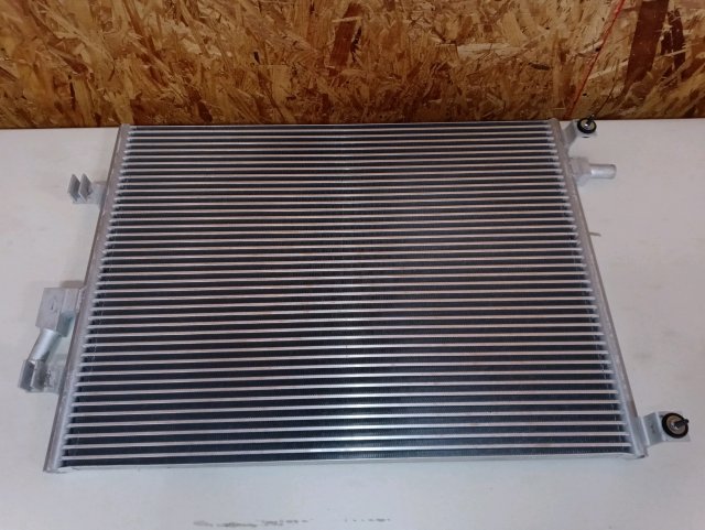

Anyone ever seen one of these..............Going to be a bitch to install. I think.

What's wrong with yours?
Looks like the front fascia has to come off to get to the Main LTR Coolant cooler
68318329AA
COOLER-AUXILIARY LOW TEMPERATURE
This is the first cooler in the intercooler loop. I think. Then it goes to the power chiller and then to the Supercharger.
Mine is full of : Dents, Rocks, size 7-1/2 steel bird shot, bugs, sticks etc........ This is the very front heat exchanger on a Demon. Next, behind this is a combo AC condenser / Trans Cooler and finally the engine radiator in the back (which is new). I definately am anal about this cooler. So, I sure hope I can get it in there without pulling the front facia. I am thinking it might slip out the bottom. I will investigate.

Ahh I see I thought it was the main cooler with that small one on the driverside lower fascia being the auxiliary. Anyway I don't blame you changing it just stay away from following those gravel trucks...

That small one is in pretty good shape.

On the Hellcat, it goes through the small 1 first then the large 1 & to the s/c.
I assume Demon is the same ?

Likely the same, plus the Power Chiller. But the cooler I am thinking about changing will be critical when the ambient temp is less than 55 deg. I am sure it is working OK but I want it to be new again to give me that last degree or two.

I know what you mean but, a couple degrees you will never see or notice on the ET.

Running my AI chiller at the track in 2000 > 2500 DA, I sometimes see IC 35 > 39* with good cool down, & when I don't get a good cool down, I might see 45 > 50* IC temp & I see about the same ET.
