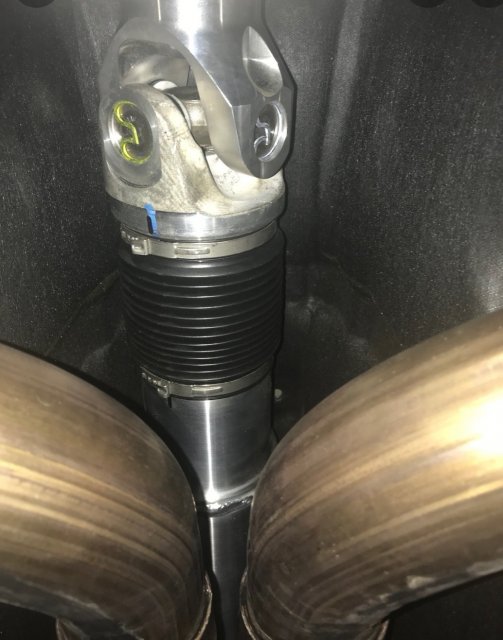

Marc if I remember correctly my CCI has a slip yoke near the trans.
The Wiles was similar.
1,758
4,389
3,441
11,063
That’s the one I was remembering! The live axle/4-link needs 3/4” of forward slip to allow for the change in pinion angle on acceleration. Guys wanting to keep the A8 need to build that into the combination and this is going to have to be it. I’ll call those manufacturers and see what they have to say. Thanks!

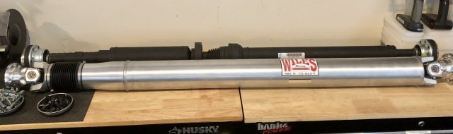

2,501
6,873
My 4in M6 Wiles looks the same as pictured above. I’m certain Ralph would be helpful, ring him up. Heres a pic vs. stock. 40AE325E-C4C0-4CAE-BCFB-5EFEEAE470A6.jpeg
