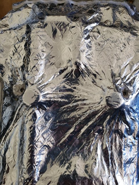

These, they are breathers connected to gear case and are right behind the seals on the firewall side of the rotors. View attachment 18508 View attachment 18509
Yes, I do remember seeing those. I definitely covered mine with the heat blanket. now Im also wondering if i Need to re-do my blanket.

no need to remove the blanket, just cut a slit close, stick your finger in there to locate the breathers and make a small cut out around them.

from those photos it looks like the oil will still bleed out even with the heat blanket covering the ports.
With that in mind, I wonder how bad it‘ll be to just leave the ports covered.

The adhesive on the FI blanket is the stickiest I’ve ever seen, but most likely it’s not 100% air tight. I wouldn’t remove the blower just to make vent holes but next time off would and with any new installations take them into account and not block them.

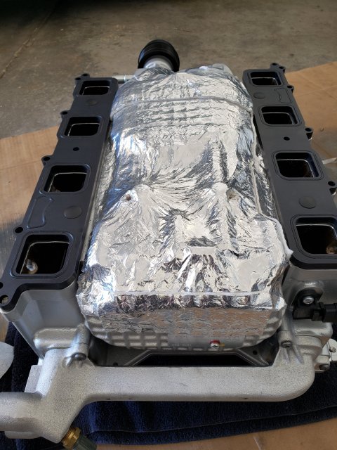

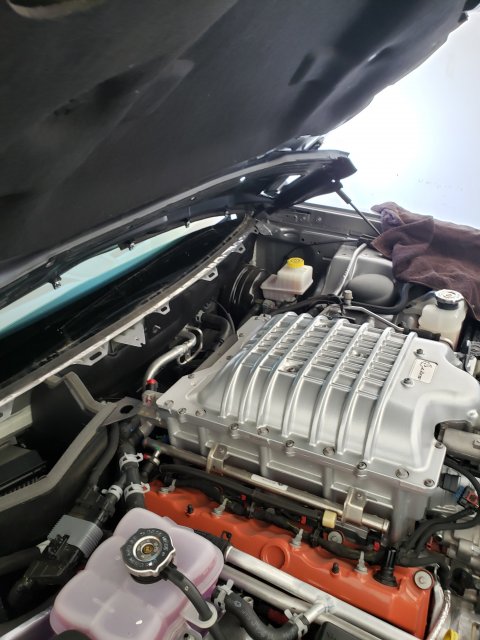

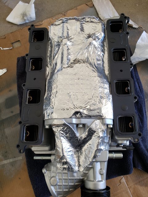

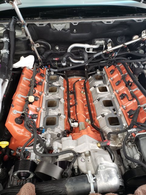

Played around for a little bit with the dowels and said nope wasn't going to turn it into an all day deal. Wiped off the heads (there is always oil there by the ports) but yes it rest was that clean. I made sure not cover up snout so I could be able to take it off to change pulley and cut holes for the breathers. 20200613_110547.jpg 20200613_122217.jpg 20200613_125330.jpg 20200613_125323.jpg 20200613_125341.jpg Here are some pics
