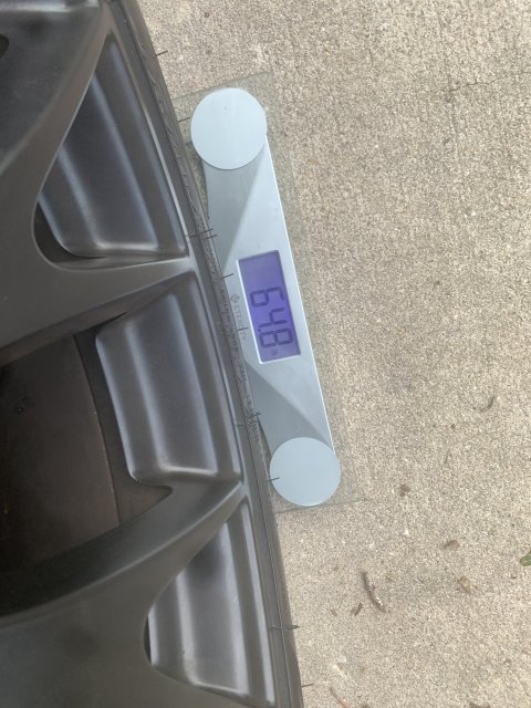

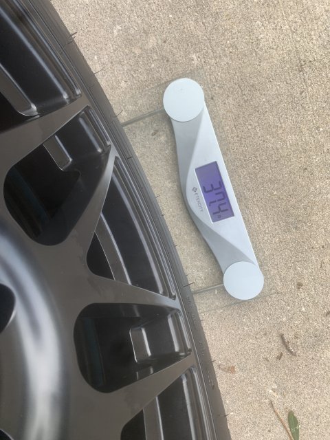

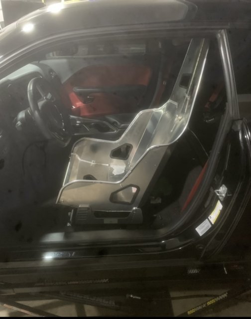

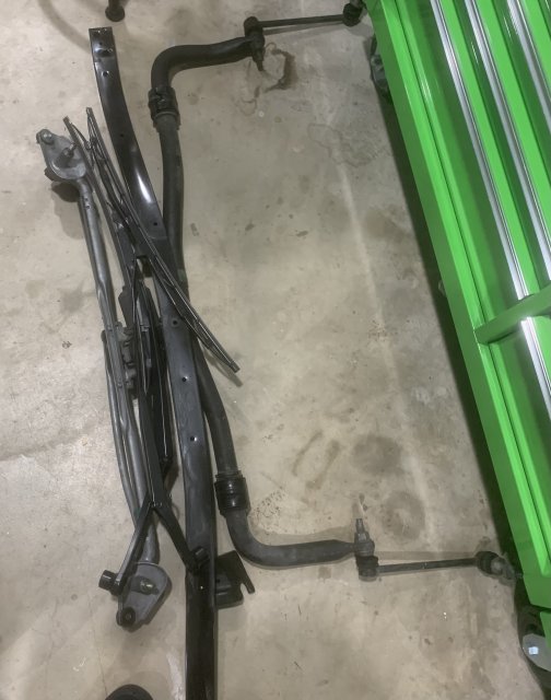

I have thick skin so hopefully I don’t have to worry about getting booted. Seats out, kirkey in, sway bar/wipers off, shaved a ton of weight per side up front with the skinnies over stock, last pic is stock wheel wait compared to skinny and beadlock. Sway bar wipers and brace weighed in at 36lbs

didn’t save much with the 17” beadlocks but got 315/50r17 mickeys on them, 18x5 Mickey et street on the front light as heck

id1300x2 injectors, twin pumps in fore hat, cradle lockout, diff brace, Redeye driveshaft (DSS 4” went out of balance), Jlt intake, 2.69 upper pulley only, blower spacers, idler pulley/bracket, running on e85 round the clock, drag setup, kirkey, getting started in the weight reduction. Line lock, few other things. Pretty standard setup
