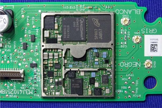

Same for the 2023. While the card is different between the 2015 and 2023 (different gen cards, both Sierra AFAIK), from everything I've been able to find, the sim's embedded on the AR7552 card. Photo below is the guts of the 7552 that does the actual transmission.
You're 100% right that if we could locate a separate SIM that would be ideal, but haven't found evidence that exists. If you find other data that suggests otherwise, would be very interested to hear.

Has a anyone tried removing the antenna jacks from the sierra board? That little stub would act as an antenna. Short of wrapping the board in a complete faraday cage I don't think there's a good way to kill cell without disabling the chip by yanking it or killing power to it.

MY15 MY16 simple FAKRA D dongle disablesall cellcomms.
MY17+ has 2 antennae (violet and pink) and a suspected onboard antenna. After both ports were blocked, the Sierra card still maintained a signal.
There are three wires, on the board: Grey, Black and White. Remove these and disable the cell. You would need to use shrink tube on the end of each wire, before applying power.

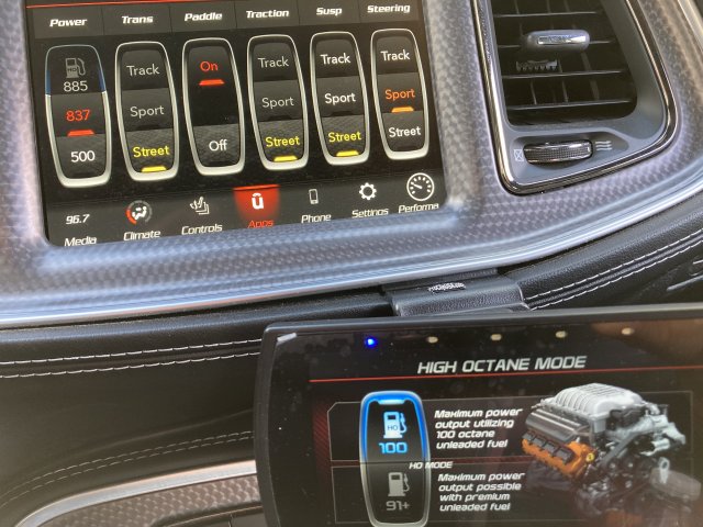

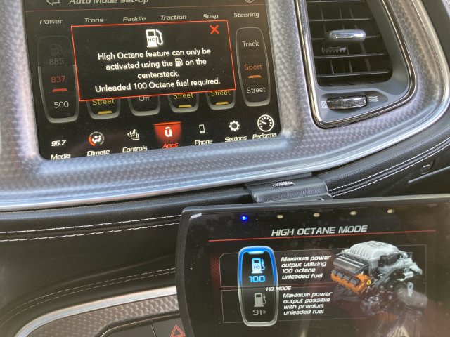

20HCM6 22RENBS2
Brings to mind...
The dash screen on Stage 2 RE's show 837/885hp, but it will NEVER highlight "885". Dodge/DC knows about it and doesn't give a crap! Not even the absolutely useless "DodgeCares"!
We are on our own, we are bastard children, cast off by the new woke. I'm starting to get worried about future parts availability. 2 weeks (so far) for the dealer to get 2 new fuel injectors!
6,225
11,706
So? Unless the hp is lower because of it, who cares what the displays show?
3,330
8,069
20HCM6 22RENBS2
WTF! 885 there but they never finished the job and made it highlight! Pure cheapness/laziness! Absolutely not the quality I, or anyone should expect from a major mfr. Obviously they don't give a crap!
