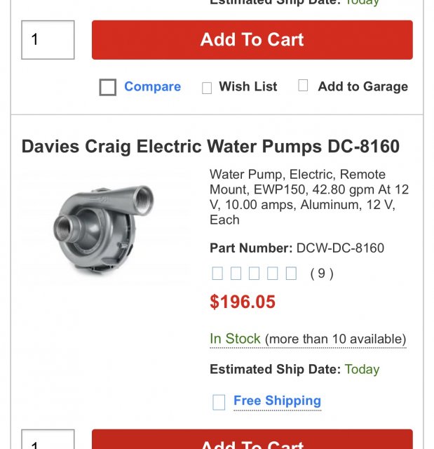

Thread Starter #56
Can someone tell me by the picture what brand and model number that pump is? It has an internal short and I need to order a new one.
7000 Posts Club
7,686
6,460
Yes Davies Craig, pointed that out earlier. It’s a pretty standard pump to use with an ice tank. Just has a custom mount which you can reuse.
7000 Posts Club
7,686
6,460
EWP150. Get the 12v version.
7000 Posts Club
7,686
6,460
#59
Can get it on Summit, they stock them.
