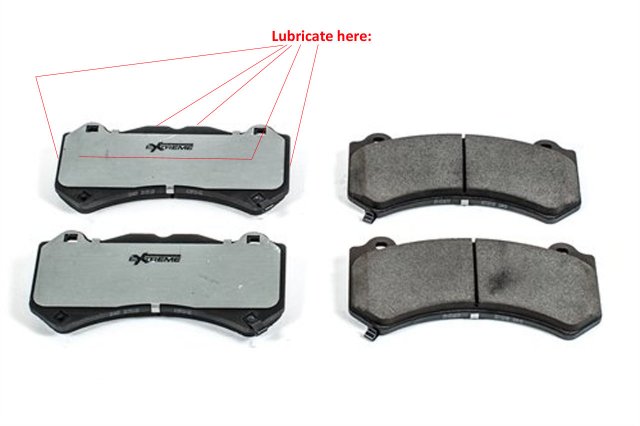

Yes, I am certain... I've done this fix more times than I can count and so had many of my former customers. That's why I made the effort to create a graphic with instructions on how to remove the paint to prevent low-speed brake noise.
All pads are the same....remove the paint. Lubricate ALL steel plate contact points with a good high-temp Silicone Brake Lube, backs (on top of shim) and sides where the steel plate rides in the caliper slots. Also, lubricate on top of the steel plate where the spring steel hardware contacts the center of the plate.
Our Cats don't have a lot of brake hardware that contribute to brake noise.

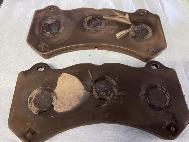

And now for my burning question...what caused this?? These are the backs of the new Hawk DTC-60 front brake pads I removed yesterday from my Challenger Red Eye. I swear I put very little lithium grease on these surfaces - just rubbed some where the pistons would contact the plate. What caused the black paint to do this? Getting these plates out wasn't easy either.

The effect is heat. Now to determine the cause. That will require a smarter brake guy than me. Good luck.
15,814
49,487
As above... ^^^^^
Heat...
The whole point of the 50/60/70/80 series pads from Hawk is to handle higher and higher heat ranges...
Not everything will stay "pretty" when it's running at 700c+...

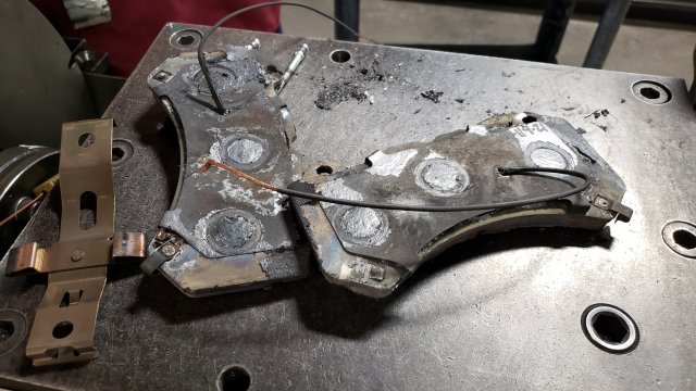

Pads from our last Dyno run.
These were instrumented with thermocouples
The peaked at ~975c
500-800c typical

DGatzby mentioned you did stuff with brake pads, a la Track Day data. These Hawks are my first set. The Bembros didn't have anything on the back plate blister up and I think I ran them as hard.
If it's normal I'll just clean them up and reinstall them.
Appreciate your response, Bull.

The Hawk paint just flakes and crinkles for me. I brush it off after I remove them after an event. The pads barely last more than 1 track day of 4 sessions on the front for me partially because of taper. I'm building up a collection of 3/4 gone front pads with the stupid idea I might burn them up as pads for a low speed track around here.
That is what has happened - crinkled and flaky paint. The pads themselves don't look too worn after my 4 hours of track use last weekend. I must not be braking hard enough, but at least I cooked the paint.
