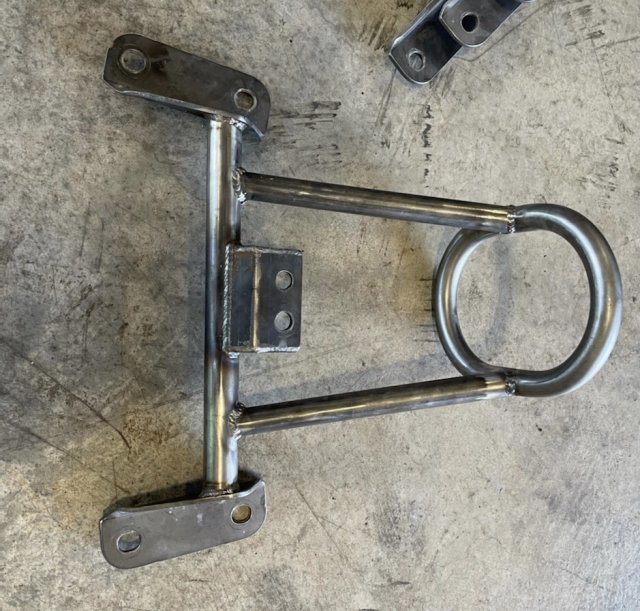

I recently added a PST Carbon Fiber to mine. It’s tested to 2800 lbs torque. The same 3.75” shaft is available for the Hellcat now. The only caution would be that you will need to do a serious job of heat shielding the exhaust if you are running on the street. I think that shaft is running right around $2k. It’s super light and balanced/rpm limit rated to 14,000 rpm. View attachment 86029 View attachment 86030 View attachment 86031
Where did you get the driveshaft loop at. I have 1 and it looks like 1/4 the strength of yours.
That is a TH400 crossmember/trans mount with the loop. Not for you. Yet 😂 we sell them when you’re ready. 422DDDFF-362F-4D72-AB28-1BBE839092F8.jpeg 53F26E87-F9DE-4BED-B7A4-3D9A84448C44.jpeg

That is a TH400 crossmember/trans mount with the loop. Not for you. Yet 😂 we sell them when you’re ready. View attachment 86056 View attachment 86057
Those are sweet! I’ve gotta find or make one for an m6 with dss and Barton. The gforce has terrible fitment. Almost got sent home the other night for not having it.
Problem is there aren’t enough M6 cars drag racing to warrant mass producing one. I don’t doubt that we could build one just like that for your M6 but it would probably run you $1k for the labor at the shop rate. Those loops that bolt to the stock crossmember with a couple bolts are bs. That DS ever breaks, it will tear one of those right out and start twirling it around.
