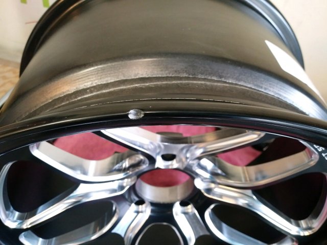

Tire rotating on wheel

Looks like about the same amount I was seeing. I've been chewing on which beadlocks to buy. Likely I'll want front/rear set (not running skinnies just yet).
So far I'm thinking:
Forgestar D5s 17x10 Beadlock 25.9lbs/18x5 front runners 19lbs
or
Billet Specialties Winlites 17x10 Beadlock 22.4lbs/18x5 front runners 14lbs
The Winlites are lighter, but are twice the cost as the D5s. Not sure if they are twice the wheel! Total weight difference between the two sets is 17lbs (7lbs rear/10lbs front). Assuming the data from Billet Specialties and Forgestar are correct.

Yeah the BS (like Welds) are pricey. Not as much as Bogarts, but still!! I have the Winlites and they are rediculously light. One thing I can say is when you hold one, you see where the money went. They are spectacular CNC billet aluminum art.

I have the D5's on the front of my car and Weld S71's on the rear. All powder coated matte black. They match really good considering they aren't the same brand. Neither are particularly light when compared to the Win Lite. MarcW is correct in that the Win Lites are a waayy nicer quality wheel. They are also as light as advertised. My only knock on them is that lots of these cars that you'll see at a drag strip have the Win Lite on them and they sort of all start to look alike after a while.
Having said all that I'm still considering the Win Lites(along w the Hoosier 28x10.5R17) as my 'drag only' setup strictly because of the weight.
In my experience the Welds have better quality control. For instance the back of a weld wheel (the hub face) is much nicer and it seems to be hard annodized. I have had Win lites come on 2 separate orders where there was similar damage to the wheel right out of the box. Also the 17X10 win lites have no chanfer at the back to accept any kind of hub centric ring. I have had to hand file a chamfer to install rings. 0301191641.jpg
