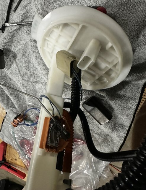

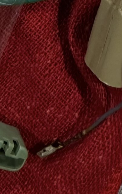

E85 in the tank all year round here - same tank since September. Yes, it gets condensation - and a lot of it (fire it up and water will come out and condensation will bellow out until up to temp regardless of outside temp on "old" fuel) I would not do a full tank and let sit, and here's why. The moisture will rust the pins in the fuel level sensors at the top of the hat that go into the connector. I've had to replace the passenger side because of this already

I say already, but this is 7+ years of nothing but straight e85

Both pins were thoroughly rusted. New fuel level sensor came with new pins already terminated, just had to take connector apart. Fuel light would blink, and would get a service fuel sensor message (real descriptive). Alfa was able to see a short to ground in the BCM (no CEL stored) and state which fuel level sensor it was. The connector is not sealed and is exposed to fuel. Not sure if they changed this on the newer models
