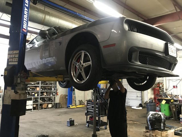

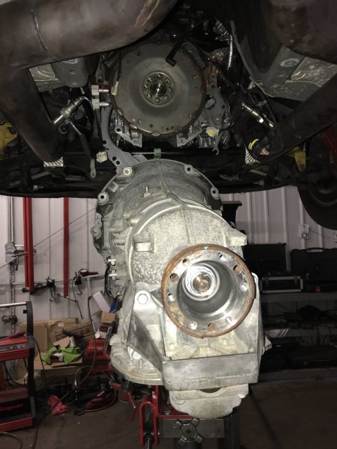

Fairly simple removal CD2B1EEC-C0F0-4BAC-BE6B-DD0A216EECFB.jpeg B648D753-CD13-454C-8259-30529735CC1B.jpeg

Looks heavy. Lol what is holding up the rear of the engine?

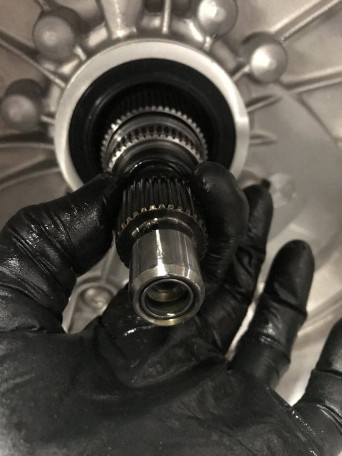

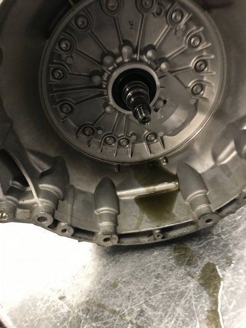

Converter,and pump pic , on these there is an oring on the input shaft that needs to be removed before removing the pump, also the pan and pump bolts are torque to yield meaning one time use only , pump bolt kit will run $60 plus and the pan bolts are part of a filter and gasket kit that I believe runs $300 plus , I’m replacing my pans bolts with steel ones so I don’t have to buy new bolts every time I service it

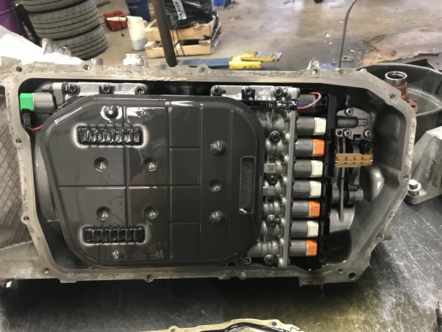

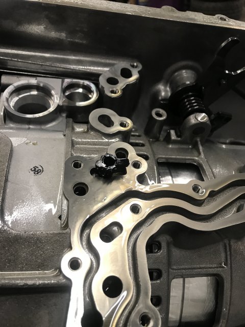

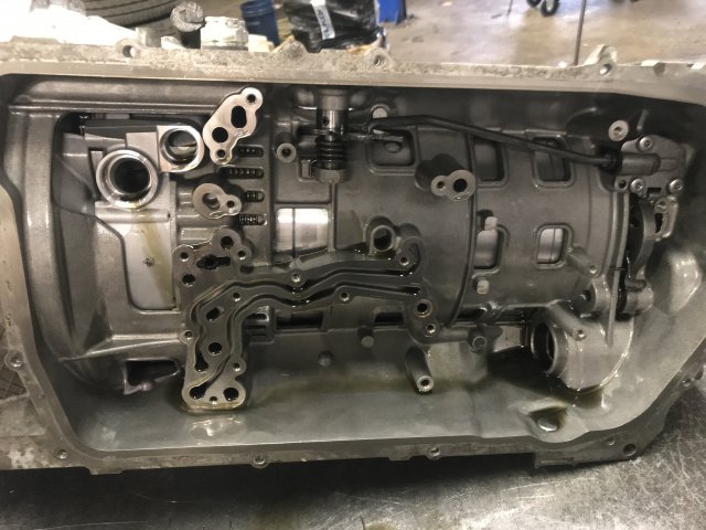

As you can see the pan looks fine
If you look close at the pic with the main control valvebody two pan bolts broke off I will have to drill them out but that is usually easy because of the aluminum 63143CAE-0298-44A1-91DA-E8606DC5342A.jpeg 8F24E6BC-953E-4AEC-85EF-5D08E25AD335.jpeg

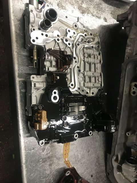

This is pics of the Valvebody before and after removal , the one pic shows the steel bracket that must have the bolt removed and bracket pulled up in order to remove the connector sleeve to get Valvebody off , remove only the bolt heads that require a 40 torx bit socket , there is also a seal that must be removed in the case before pump removal

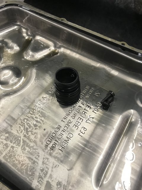

This is the connector sleeve I mentioned FBADF643-590F-408A-89C5-0EF62A9C1A04.jpeg
