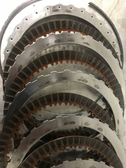

On here is the break down of the c, e and d clutches as you can see the E and D clutches have definitely been slipping the c clutch is ok as it shows no signs of slipping the order is C E D
AS FROM FROM THE PUMP TO THE REAR OF THE TRANS YOU HAVE IT AS FOLLOWS A B C E D

Maybe it is me but those stock clutches look perfect, are you sure that the clutches are burnt? What color is the fluid? It looks dark green which is normal (not burnt).
I love the tear down and photos, please walk us through this, very useful.
Cole look at the e and d pack
The steel s tell it more so then the clutches , now stay off that shine buddy image.jpg image.jpg

Oooops, now I do see and I am on shine with Cole. He lost his per spectables and can't see. Can't miss it now.

if you look at the steel plates you can see the black heat spots which is to the point its distorting the metal in the plates ,unfortunately as I look at them theres not enough material to cut the pressure plate(backing plate) to add another clutch and steel to the clutch pack assemblies as they are already not that thick
