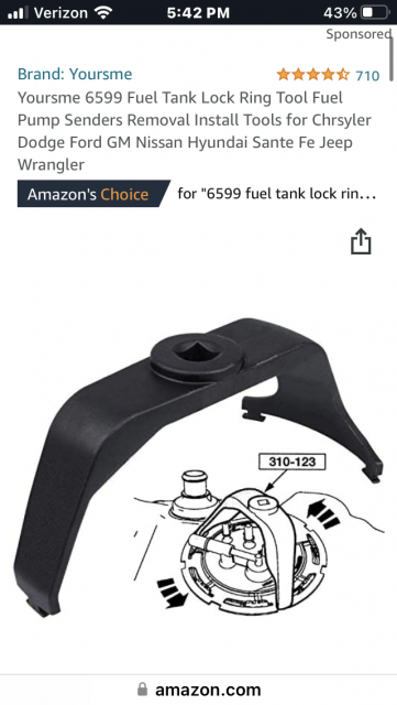

Spend $20 on this and save yourself grief on the bung, this the tool I have.
https://www.amazon.com/Yoursme-6599...2lkZ2V0TmFtZT1zcF9waG9uZV9zZWFyY2hfYXRm&psc=1

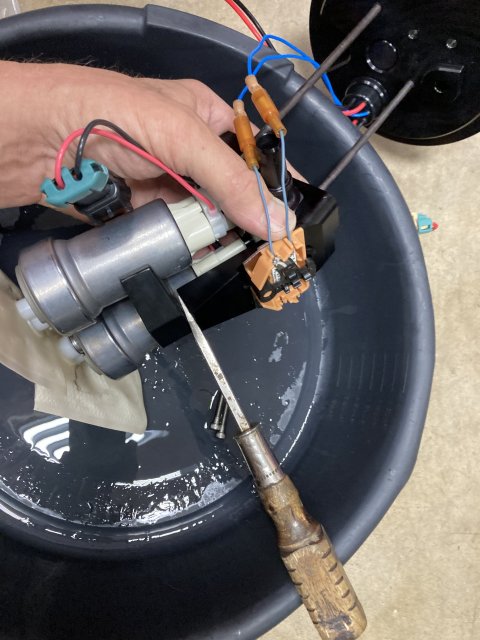

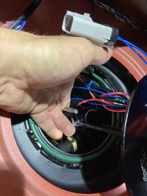

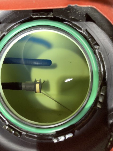

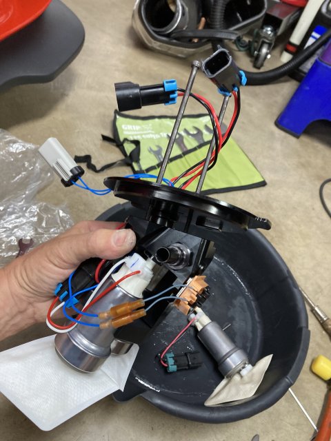

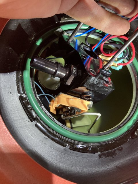

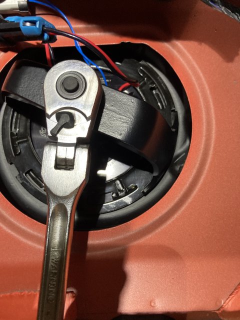

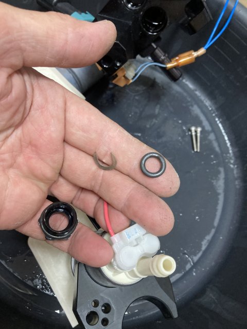

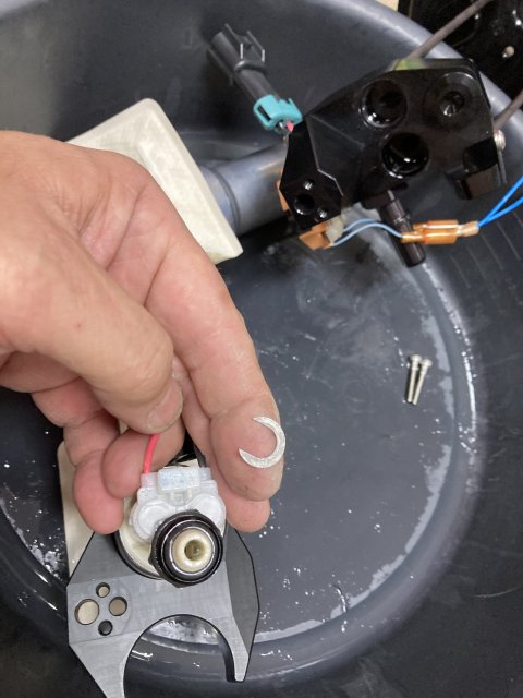

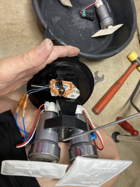

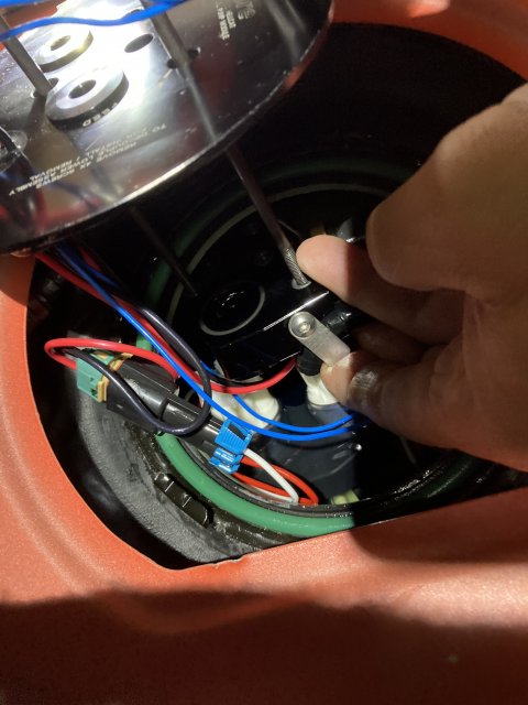

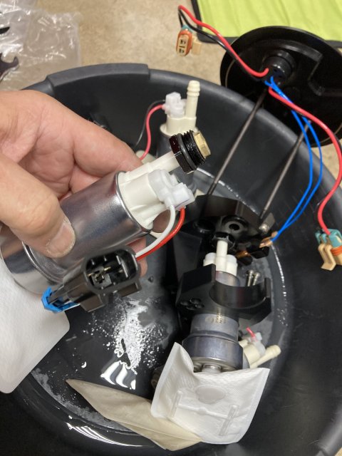

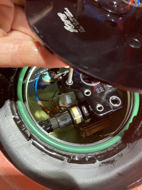

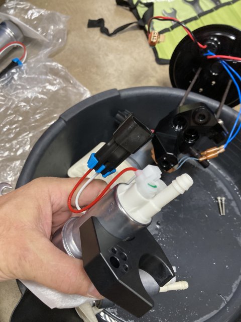

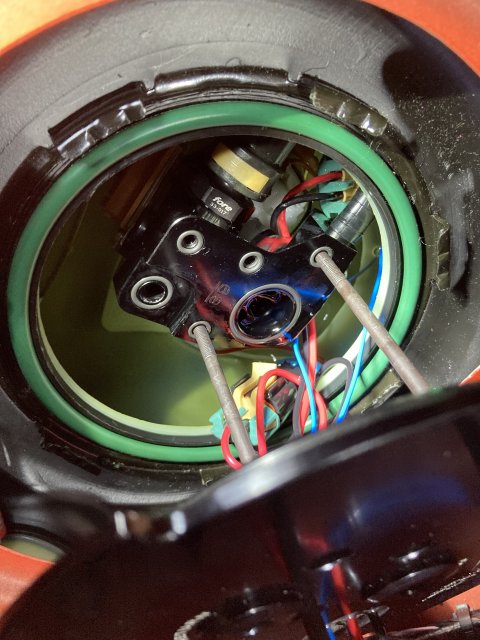

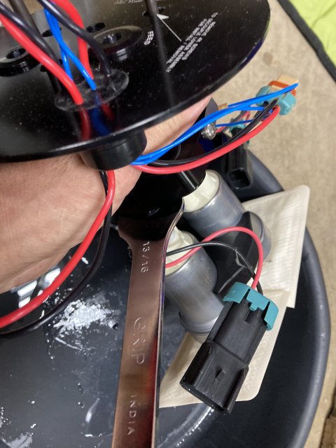

Here ya go some pictures to help what you’re going to see. Your going to need 2 long 5 mm bolts to keep the hat top and bottom aligned properly, and make sure none of the orings fall out of the hat to base seal area 4E86A478-679C-4268-8D24-1AB77341E267.jpeg 9092C30B-D06B-438E-B389-6E2D8A28A302.jpeg 8E78D990-5D6C-4D70-93B6-865DDF765BE4.jpeg 39437211-F033-4B05-8A55-8051CEDD604C.jpeg 2760E04D-6DCD-44A3-B7A7-D7DC78F77892.jpeg D56D1C78-CA06-4FCD-A4EC-D3F488B91601.jpeg 0E42A0C0-5F83-42EF-B42C-3423E336ABFE.jpeg 4206FF08-C8BF-441A-B761-794C95F79053.jpeg 12B4741A-7963-46EF-AA44-53972F18F7D3.jpeg 1F4BC1DA-AE2E-4033-ACE1-FC1B32D4F591.jpeg

Hopefully all these help, tank a oil drain pan in with you and just put the assembly in it, do all your work in it, drain it and tank rebuilt assembly back in with you, no mess, no lingering gas smell.

Unfortunately the pictures didn’t load in chronological order, it’s easy really.

Thanks for those pics. I didn't realize the pumps had c-clips holding them in, I'd have probably just tried to pull them out lol.

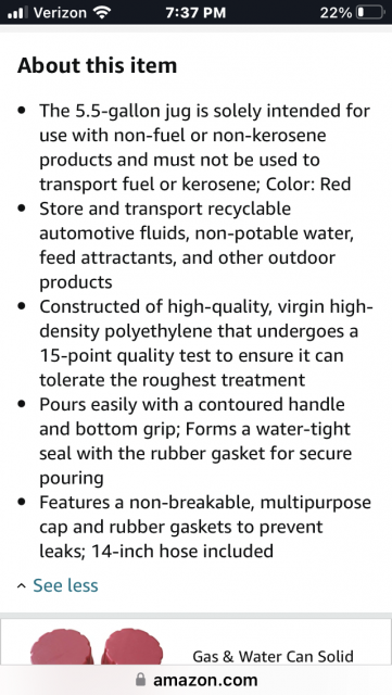

Weird they say this about those jugs too????
29,507
130,896
3,319
7,832
I use mine for fuel transfer from the can into the car.
Sounds like from the description they are not an approved fuel transport container?? “non-fuel” liquids
Maybe they make different varieties?
