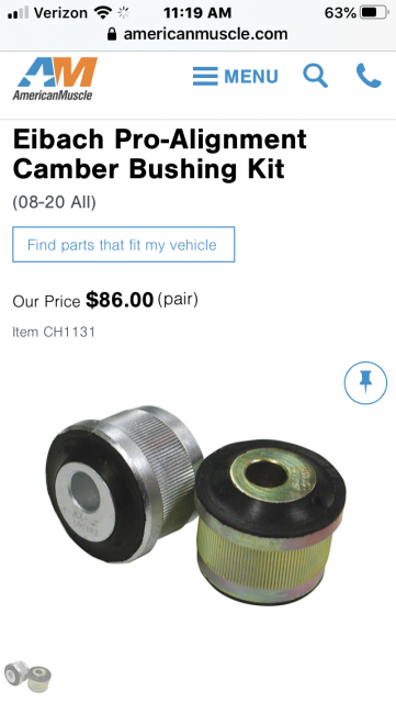

Correct . You get 2 bushing in the box . 1 goes on the aluminum upper control arm on the out side . The other bushing goes on the stamped steel upper control arm on the out side .
1 box does 1 side of the car .
Oh, my dumb ass was thinking it was just doing the aluminum arm, not both arms, thanks for clarification.

You have to do both arms the same amount on each side .

YES!! please post how it’s done I’m curious and for 160$ may rebuild my stock removed ones and see how they work, I just love experimenting lol
These are Stainless, look like the better of the 3 posted?
Thanks, I'll let yall know how it goes when I get to it, it didn't look to bad on the You Tube vid. I just watched but you know how that goes.
I noticed that the moog ones are life time warranty, wonder if the rubber is any different from one to another on these ?
What's even better is no matter who you buy them from it has "SPC" stamped on it . Lol
OK, whats that mean ?
4,870
11,001
They are all made by the same manufacturer ( moog) and sold by different resellers .
