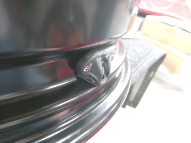

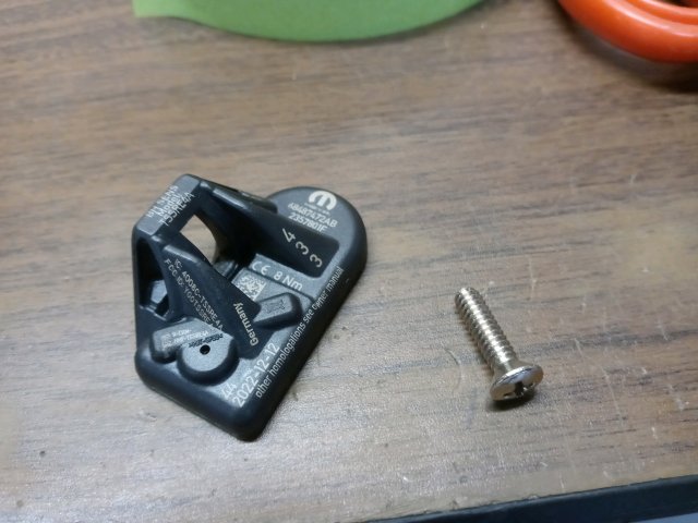

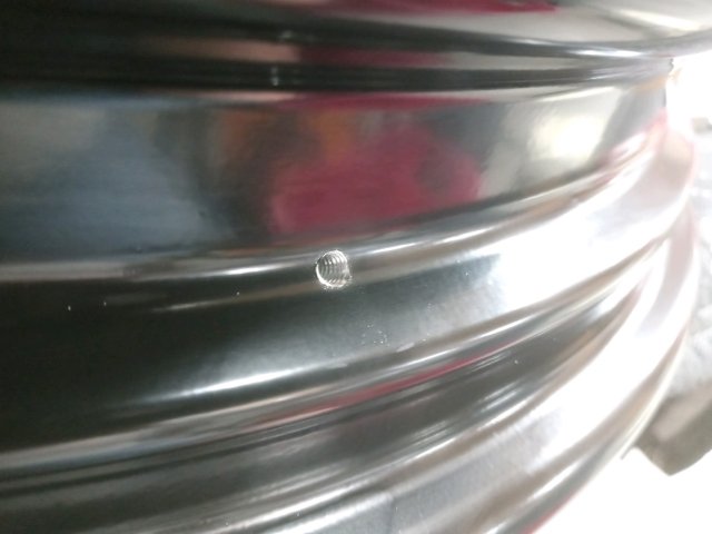

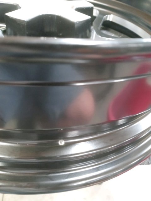

Just curious if You all think I am going to kill myself? One of my pet peeves if the lack of the ability to put a TPMS sensor in the Billet Specialties Win Lite Skinnies. So.............
Screw is an allen head machine 10-24X ¾” (not the one in the pic) and the sensor is about 2/3 the size of the older ones. Hole is blind. Sensor is clocked 180 deg from the Valve Stem to attempt a more nuetral balance. These are for 22 model year and newer, because..................
Screw is an allen head machine 10-24X ¾” (not the one in the pic) and the sensor is about 2/3 the size of the older ones. Hole is blind. Sensor is clocked 180 deg from the Valve Stam to attempt a more nuetral balance. These are for 22 model year and newer, because..................
. View attachment 105986 View attachment 105987 View attachment 105988 View attachment 105989
Looks like a good idea to me. Don't forget the loctite.
Loctited the screw threads, under the head/washer and I ran a bead of silicone on the back edge opposite the mounting screw to dampen vibration. I REALLY like having TPMS even at the race track.
15,830
49,539
FYI, Loctite WILL attack engineering plastics and cause them to fail.
Easy answer is to keep the Loctite on metal threads only.
You also removed your rear swaybar so idk about that lol

You’re typically always running 50 psi+ to meet the load rating on the front tire, and you can’t adjust the factory tpms system up that high so it’ll give you a warning, so imo tpms on the front are pointless anyway. @16GoManGoHC2 is a machinist/engineer, maybe he can weigh in on the saftey of the tap you did. It’ll probably be fine
