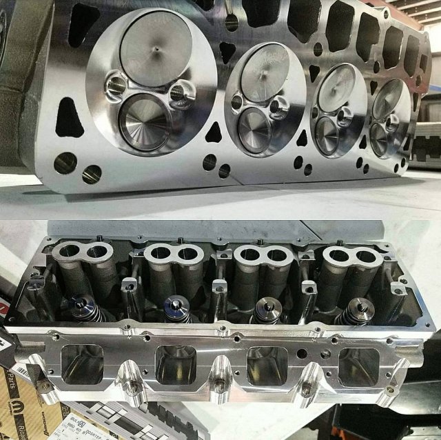

ZHC did you upgrade your heads? If so who did the heads for you?
Yes I upgraded with Thitek Bear Gen 3 Hemi heads. Unfortunately, I don’t have a before and after of how they compare versus stock or stock ported heads on this setup. They sure are shiney though.

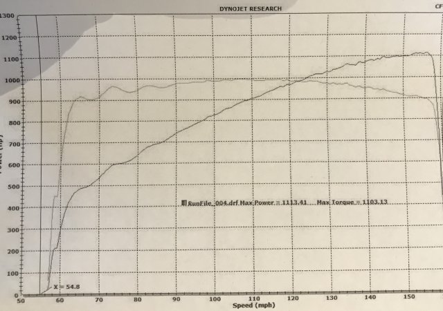

Awesome power and that dyno graph is about the best I've seen for smoothness..
3,440
11,057
I agree. And if Z doesn’t mind..... I’ve seen the same thing with my Whipple. They have gotten some bad press from a few who for whatever reason don’t like them. My engine is very close to ZHC’s as far as the build goes. It produces its power in such a smooth/liner manor it is noticeable compared to a pulleyed 2.4. It actually drives better on the street. Here’s my dyno graph. It is not corrected. Temps were near 100 degrees with a da of close to 3000ft. This was the “street” tune with max 17 degrees timing on e85. I don’t have a copy of the “race” tune using Ignite 114, but it picked up 40whp over this. If I can get mine to the track anywhere near what ZHC is doing, I’ll be beside myself!! 2ABE8D6A-1F7F-40F7-992A-EFD53476F617.jpeg

It may be a surprise to some folks, but I never had a chance to dyno the new build before I ran the 8.9's last week. After making several 8 second passes, I decided to change that fact and see how much power she's making.
The 8.90 tune as-is made an SAE corrected 1137 WHP and 1015 torque. After a couple tweaks, I ended the day with 1155 WHP and 1029 torque.
Dyno Vid:
Here are my dyno results comparing power made on my previous stock motor setup with a 2.50 + lower versus the built 427 Whipple I'm running now. View attachment 4518
Very nice! What amazes me is how close the tune is before dyno to the final tune. Whoever tuned it before the dyno did a heck of a job.
