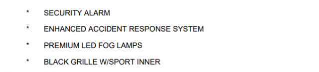

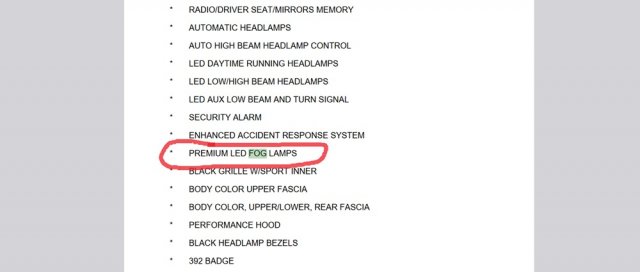

Okay now looking at a more comprehensive report we generated at order. It has:
NHA - ENGINE OIL COOLER
NMC - HEAVY DUTY ENGINE COOLING
LTE - PREMIUM LED FOGLAMPS.
I am with @drag racer, these don’t really have an oil cooler like the HC, I sure don’t see it and the heavy duty engine cooling is probably a larger radiator than a 5.7. It runs too hot and needs a real oil cooler under my foot anyway. Soon it will help to just screw the warranty, get a tune and get it a correct thermo to stay at about 190 where they like to live.
But the LED fogs are effective and very useful IMO.

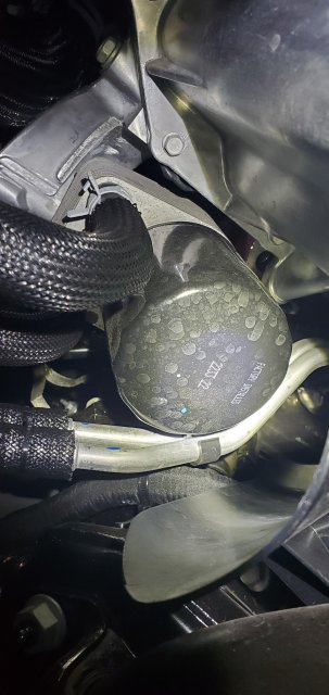

For my 2024 SRT392 AlcHEMI, the Build Sheet Data shows "Heavy Duty Engine Cooling" and "Engine Oil Cooling"...the "EOC" is the coolant, sandwich/plate-style cooler...which actually help heat up the oil faster at start up, then does slightly cool down the oil when it reaches the 220-235° temp since the coolant is at around 205-215° temp.
On my Challenger SRT392, I swapped in a 180° Thermostat and was able to set the fans to progressively kick in at 185/188/192°...way better temp drop than what the factory "cooler" does.
Here's a pic of my new Durango SRT392 oil filter and cooler...interesting to see the oil filter says right on it, "Factory Installed"!! (I was disappointed to see that it isn't an MO-0041 "White" (Wix) Mopar filter).
6,163
11,618
I've never seen one that didn't come with the regular black filter, and that said factory installed on it.
I thought I remembered my 2015 Challenger SRT392 coming with the White Filter..but I could be remembering wrong 9 years later.
I'm thinking to do a 500 mile oil change and swap over to the White Filter (I really like the White Filter better) and Penz Ultra Platinum 0W40..I just got a Fumoto F106S valve yesterday for it.

2024 Dodge Durango SRT392 AlcHEMI-DG
Then again, I never had a Viper.
I'm thinking to drain, clean, and keep the "Factory Installed" oil filter as a cool sovereign..I also have never seen one like this before.

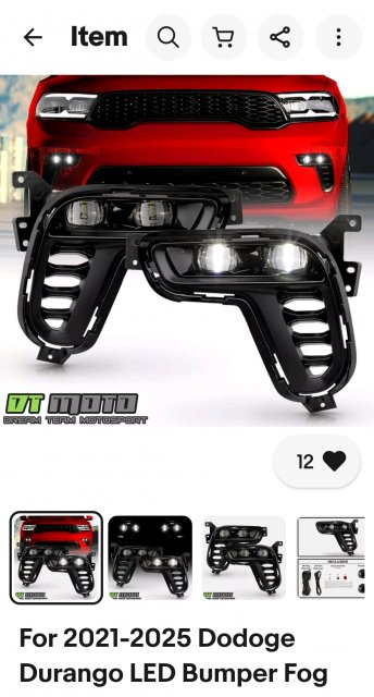

I just bought this from Ebay instead...
https://www.ebay.com/itm/1353448970...59hyB15SRO&var=&widget_ver=artemis&media=COPY
This kit has the front & rear trim pieces, foglight assemblies, wiring harness, etc for ~$109 bucks..I'll tap it into the Fuse Box #F40 "DRL/Headlamp" location, instead of the OEM Switch I listed in my above post, so that it comes on all the time with the DRL/Headlamps. While not truly legal being on all the time, you could run the supplied switch into the cabin to turn on/off as desired. I used AlphaOBD to reprogram my 2024 ram Laramie G/T foglights to not dropout with the Highbeams and stay on with them instead (I live out in the country and it's dark..I'm sure someone will comment on this). Screenshot_20241122-074112_eBay.jpg

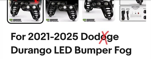

I dunno, maybe it's just me ...
But I'd be hesitant about buying Dodge parts from a site that can't spell "Dodge". Lol
