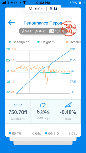

Run these, did my best street 60-130 on them after running Nitto’s for years. They last 3x as long too. Beat the Nitto’s by 1/2 second.

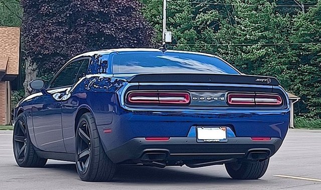

Mag my street set is the 305/35/20 555r2 on 10.5s and 275/40/20 555g2 on 9.5 fronts. I do like them (a lot), but I may go with conti next for street like @16GoManGoHC2 ^^^^

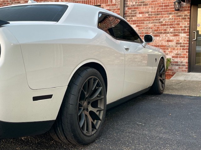

I have run the 305 Nitto’s on the stock 9.5” wheel but they do bulge some. Ended up using 10.5” wide Voxx replica wheels & they fit perfect.
Thanks for the reply. The loose wheel is the replica 11 inch? Which Nitto is that? The 35R20 or the 50R20 (looks like the 35 to me)?
That is a 10.5 Replica wheel & the 305 35 20 Nitto 555 R2 tire.
