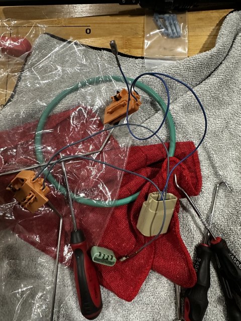

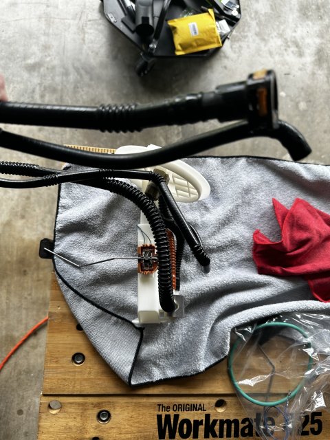

Finally wrestled some pythons and did the passenger side jet pump fuel level sensor. That 100% was the problem. No splicing needed, I disassembled to connector, depinned it, and put the new one in. All fixed up and hopefully won’t have to play with the fuel system for a long long time. FYI, that white clip on the hose that goes to the driver side was white. It turned orange in 2-3 months. I see it losing its tension again eventually.

@AlleyCat i can definitely see how the jet pump can be easily broken if you force it out of the tank (since doing mine). It’s a shame, but I think the person you did yours broke it pulling it out of the tank

I used self-solder shrink connectors for the wires and added a 2nd layer of heatshrink over that and pinched both ends tight to make sure they sealed.
The heatshrink and the actual self-solder sealing connections both looked good after 2 seasons. The only issue my drivers card had this time as an odd residue bridging the solder points for the wires on the card board itself.

The stock connector which connects to the stock hat in both the stock pump and the jet pump are exposed (the back side of the pins) and are submerged when the tank is full, only think you have to worry about is metal to metal/ wire to wire contact

Also, the terminals on the old passenger fuel level sensor were extremely corroded and rusted, almost rusted through. This is definitely due to non stop e85 use. Something to keep an eye out for.
