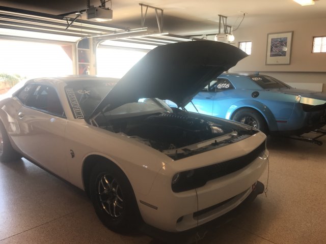

Fairly cool garage now 😜 B534248B-777D-44CE-B87F-A8A8D09D5E31.jpeg CA70DE61-9A28-45E3-B05D-B9D50E5AAFA9.jpeg FAAA8FCB-E321-4C23-9943-1C88AFB98188.jpeg

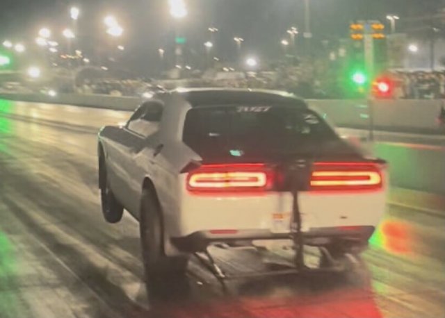

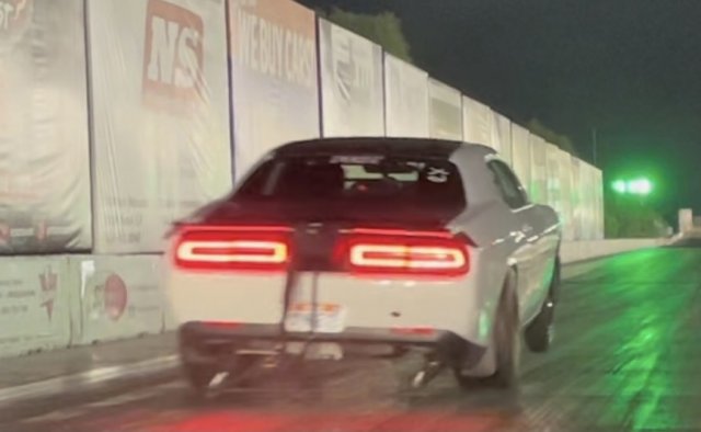

Now the adjustments and track tuning start. We’re going to be using some select sensors that work with the Holley Dominator to make the power adjustments necessary to get it down the track. That and suspension tuning. Both of these are areas where we don’t have the necessary expertise to just do it. We’ll need to go outside and Adam says he knows some guys. 😂. First good example is the rear suspension. Pictures are worth 1k words. What do you see? C724E8F5-BB3D-4844-B8B3-64EF2BBDC0D3.jpeg 9940718A-98F9-4173-9225-189CA2DBED76.jpeg

Car looks like it is loading the right rear on the hit.

Good eye 🫣. What it’s actually doing is loading the left harder than the right. That is the anti-squat action where the 4-link is lifting the weight of the car and loading the tire. The separation you see over the left rear is missing on the right. That’s all suspension adjustment. We need to put the car on scales and start making loading adjustments to the track bar and probably some shock settings to correct that. What you see was making the car go right when the wheels were up. Not helpful 😒
