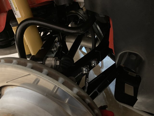

Done, from this
To this
The Speedlogix ones use serrations, each click is .030”. I set them 2 clicks out from matching the OEM arms.
View attachment 20090 View attachment 20091
Installing the 6 arms was a breeze, the Diff Lock Out kit was the time consumer. Could do a second one in about 2/3 the time this took after knowing how it’s done now. It’s ready for a test blast.
I shortened a 4 foot level to fit flat on the wheel lip too set up arms before I did the alignment an it worked great.
when I started in the trade years ago that`s all you used for alignment equipment, with bubble an measurement scales.
no fancy stuff like today.

B Woody, don’t think there’s any issues, going for a test ride this am
Staying tuned for results for sure.
I plan to do AAD hardware but also need a shorter link BUT at least one of us has seen interference between the sway bar and AAD with shorter links. That was DGatzby with the Razor's Edge/StolenLogix billet rear links.

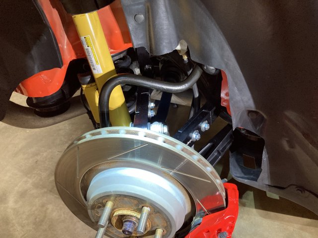

Update, drive to a car show today, send fine alignment wise but will schedule one for next Saturday. Body roll much reduced in conering. I only did a few mild hits on the way here, didn’t hop at all but my tires are at 33 psi hot yet, real test will be when I lower them to 26 and do a street 1/4 pull, maybe later today but I want to check over the security of the lock up bolts first which requires removing the tires. But so far so good. Can feel a bit more NVH but only slight. B0AFF03C-7CC5-42D6-B7C7-D39D4444FD75.jpeg

Update, drive to a car show today, send fine alignment wise but will schedule one for next Saturday. Body roll much reduced in conering. I only did a few mild hits on the way here, didn’t hop at all but my tires are at 33 psi hot yet, real test will be when I lower them to 26 and do a street 1/4 pull, maybe later today but I want to check over the security of the lock up bolts first which requires removing the tires. But so far so good. Can feel a bit more NVH but only slight. View attachment 20141

When you go in to check those lock nuts and stuff...make sure you rip a couple sharp corners real good and check for marks on the arms and sway bar.
If yours clear that's a bit of good news for me.

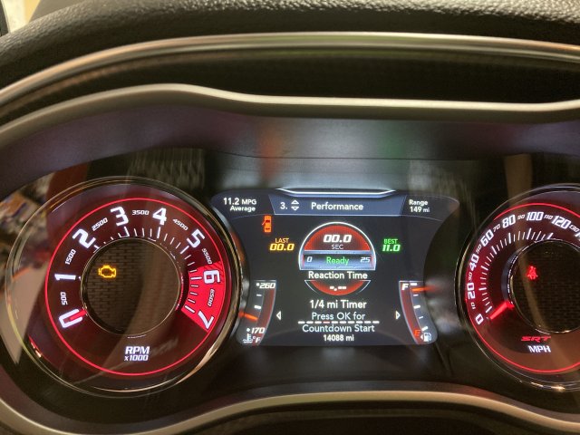

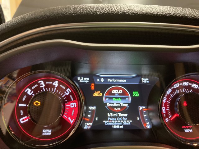

I couldn’t wait, no traffic, bridge to Mexico was all mine. Probably my best street 1/4 this season according to the car, battery positive just pulled while doing the work yesterday, my Gtech timer out for upgrade. It’s 88F here, Nitto NT05R at 32 psi and hot, no burn out. Spun in first and a bit in second peddling it but pretty impressed with the times. Now I’m home and will pull tires for inspection of arm bolts and for any rubbing. 273553CC-2B96-4839-AF3B-765FA8A02C6B.jpeg E84B904A-A3AF-4681-AC13-515EBD1FC8D6.jpeg 105B27F7-C813-4C3C-BF1E-F3E9324E671A.jpeg C6153C26-A5B4-4795-AA71-81FDF5C58A94.jpeg But here it is from the car timer.

#95

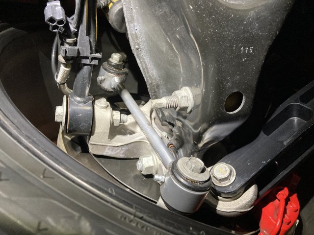

That interference may only occur at full compression according to Dgatzby...but as you're aware 17's will hit at full droop/extension without the links.
It's not likely you'll encounter this on the street unless you're into actually hitting the .93g+ that the cars are rated at.

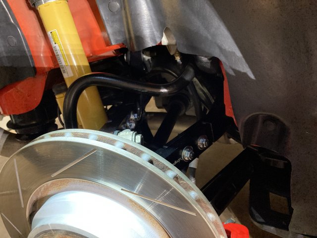

So far so good. Nothing moved and all stayed tight and no signs of rubbing.
G’s, pulled .85. On my 9.998 pass at the track pulled 1.68 G’s. Hoping to get to the track again soon.

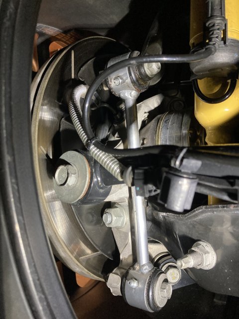

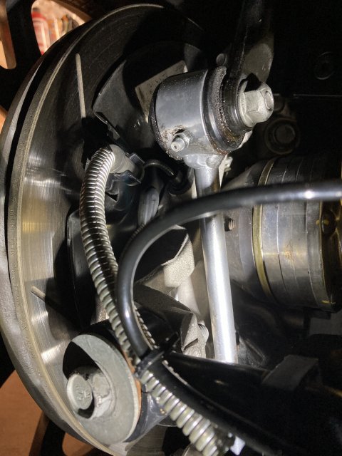

Man that looks close but if it clears it clears. I guess they are 1" shorter than stock according to an older sales page I found.
I need the end links before I'd need the arms. I should probably order the full set F & R.
3,543
8,377
These are 9” center to center, I think their 2” shorter then stock, measure yours and you’ll know. They don’t look like they could hit any where.
