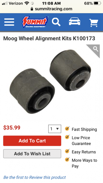

Are the stock upper arms able to be adjusted for toe & camber ?
1,758
4,389
You can use moog K100173 on the rear upper forward arm to get plus or minus 1.5 degrees camber with the stock arms.
@Mean Cat
See moparjims comment . It's a little time consuming but will net you the camber that you want .

I made a suggestion of using these on another post on one of the sites but no one chimed in on if they work or not. They where a different brand though but same concept.
You will get the camber but still have all the flex and squishiness of stock .
