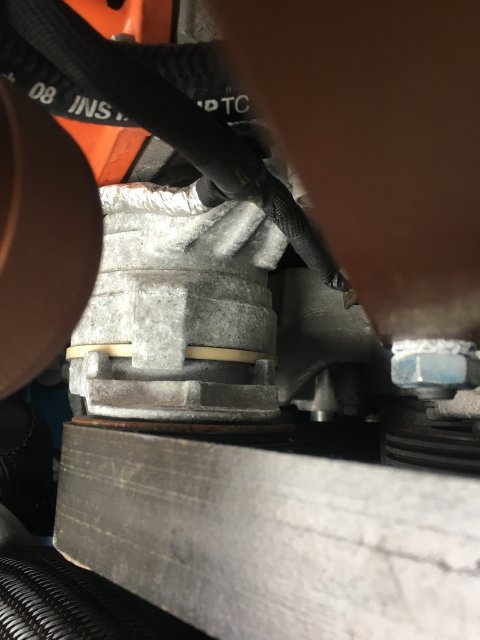

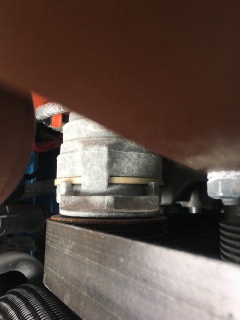

Here’s another point of concern for my install.
this is a picture of the belt tensioner on my car in stock form. It looks to be on the tighter side.
im worried once I install the spacer plates it’s going to be way too tight.
That's where mine ended up after I installed the spacers. (Stock pulleys/belt)
really?!?!? What the hell am I supposed to do now!
the tensioner might be at its limit if I install the spacers !!

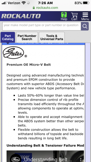

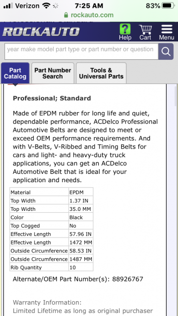

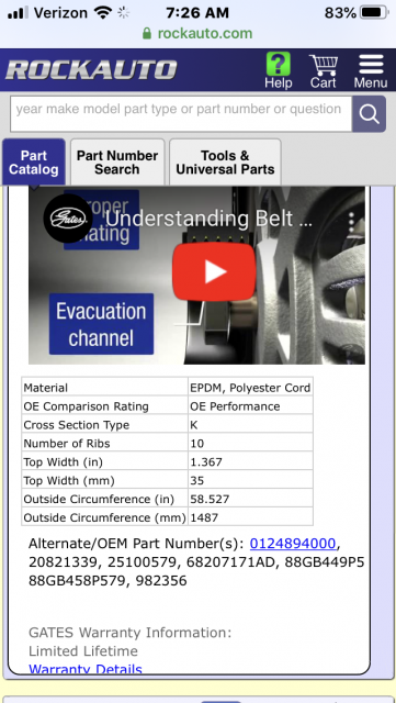

Stock belt info
BFAA30D1-11EC-47C4-B69E-2FF6A4F2B810.png 30AE78B6-33CC-41C4-9D8D-46B1EE1D3809.png 849E05BD-3DC0-4BE4-B950-6F6089FC7E98.png

that belt you linked to is only 5mm longer than stock.
id be more comfortable going with a belt that is 10mm longer than OEM instead. Since I am adding 10mm to the system by installing the plates.
im on the Gates website trying to figure out what the next size up belt is.
I gotta say it’s not as easy as I thought it would be finding the next size up in belt !! GEEEZZ!!

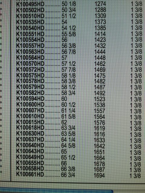

after much digging around in google, found this image (from the old forum). Gonna leave it here in case someone else needs it.
these are the Gates belt sizes.
seems like you are only able to go up in size from OEM by 5mm. The next size up from OEM is a whopping extra 1&1/4. That’s gonna be way too big.
anyone have any other suggestions to go up 10mm from OEM belt.

In this nomenclature the 580 means 58.0 the 585 means 58.5 inches and so forth so you can pick a longer belt knowing such. Look at the data off the rock auto website and compare the circumference of belt to that number and you will see they match.

Ok fellers, after an entire morning of looking into this I’ve arrived at a solution.
OEM belt effective length - 1472mm
Gates K100582HD effective length - 1478mm
Dayco 5100585 effective length - 1485mm.
since I’m going up 10mm by installing the FI plates and my belt is already on the tight side (see picture above) I want to add at least 10mm to the new belt.
Effective length difference between Dayco 5100585 and OEM is + 13mm so I’m going with Dayco.
I was hoping to do the Gates green belt cause I love the green belt look. Maybe when I swap OEM pulley ill be able to use the Gates.
thank you GoManGo and Hpindy for helping me out. Hopefully someone else down the road will benefit from this thread.
