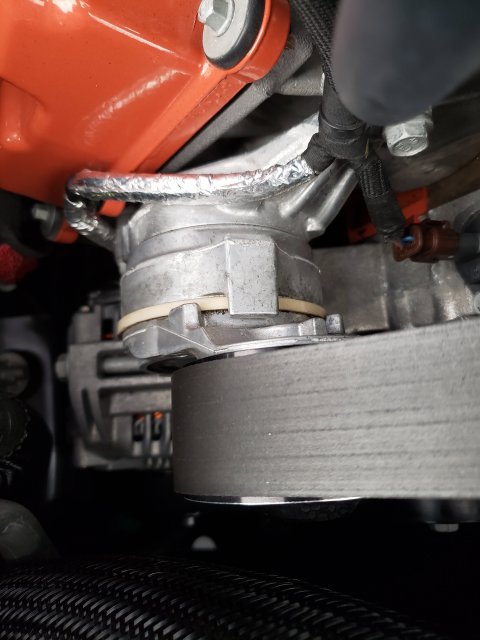

Did the Dayco fit? I just installed new idler and tensioner pulley and my tensioner is to the left side like pic a few posts ago. Once I put the plates in there will be no way the belt will work. I was looking at the gates hd belt 100582 but I don't want the green belt 20200531_123046.jpg

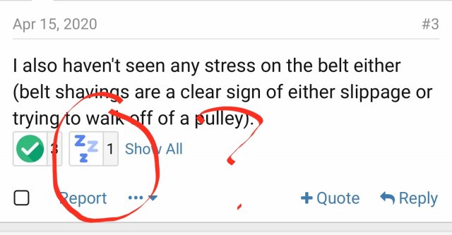

I also haven't seen any stress on the belt either (belt shavings are a clear sign of either slippage or trying to walk off of a pulley).
@Paladin06
ZZZs???

why Z's though?

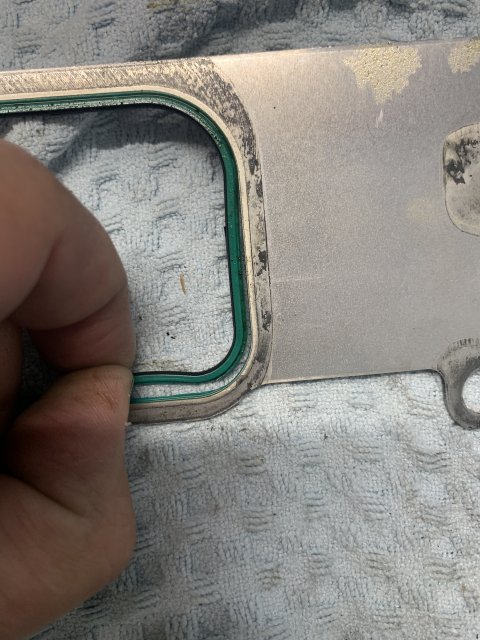

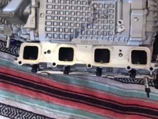

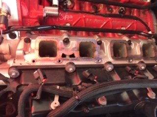

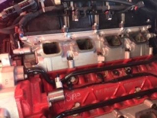

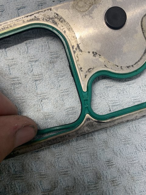

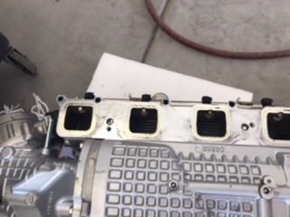

So I did this exact mod and took her to MIR over the weekend. Good times had by all, not a single issue with the car. Boy am I glad I did the swap sooner rather than later. The gaskets where letting oil blow by, the crank case was definitely pressurized. Take a look at these POS gaskets.
The ones from my Hellcat looked ok but the Redeye had some blow by for sure.

My IC was pretty much oiled up... I'm glad I got rid of the bad gaskets when I did. I could only imagine how that engine was feeling after being driven.

Did the Dayco fit? I just installed new idler and tensioner pulley and my tensioner is to the left side like pic a few posts ago. Once I put the plates in there will be no way the belt will work. I was looking at the gates hd belt 100582 but I don't want the green belt View attachment 18034
Yep, Dayco worked like a charm. My tensioner is almost perfectly centered.
