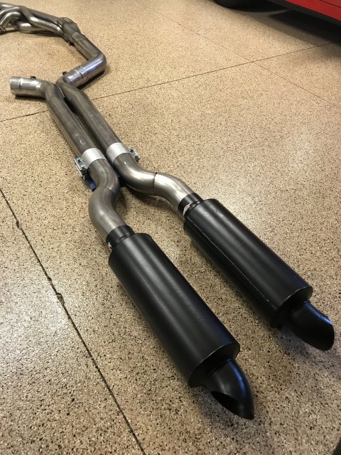

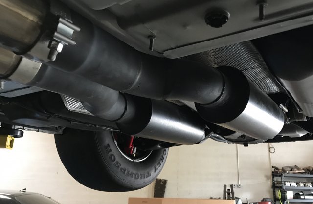

There’s this thing called a welder...... 🤔 6D869D96-52E7-4740-AB4B-F2D902021547.jpeg AFEE6075-5C9F-4CDD-B8E2-028EDAE6A53B.jpeg
